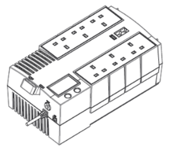

The Battery Backup Unit supplied by BT is the CyberPower BR1000ELCD.
Diagram of a battery backup unit.

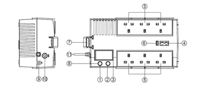

The Battery Backup Unit includes several ports and indicators that help you connect and monitor your equipment.
Diagram of the ports and indicators on the battery backup unit.
  1. Power button – Turns the Battery Backup Unit on and off.
  2. LCD Display Selected Switch – The switch can be used to select the LCD display contents including Input Voltage, Output Voltage and Estimated Run Time. The toggle frequency is set to one time per second. Holding the switch for more than two seconds while running on battery will silence the buzzer.
  3. LCD Display – High resolution and intelligent LCD display shows all the Battery Backup unit information with icons and messages.
  4. Communication Protection Ports RJ11/RJ45. Do not use these ports. These are communication protection ports that will protect any standard modem, fax, telephone line, or network cable from surge and spikes.
  5. AC Outlets – Connect your supported devices to the sockets marked “Surge and Battery Protection”.
  6. USB Charger Port – Do not use this port. The UPS provides charging for external equipment via this port.
  7. Cable Collector – Collect the cables connected from the AC outlets in the cable collector.
  8. Led Indicators – The power on LED lights up when the UPS is ON.
  9. USB Port To PC – Do not use this port.
    This port allows connection and communication from the USB port on the computer to the UPS unit.
  10. Input Circuit Breaker – The Circuit Breaker provides optimal overload protection.
  11. Input Power Cord – Connect to 240v mains supply.
