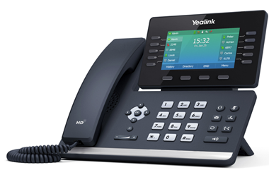

Yealink T54W phone
  • Yealink T54W phone – including the base unit and handset (pictured)
  • Handset cord (pictured)
  • Phone stand (pictured)
  • Power adapter
  • Ethernet cable

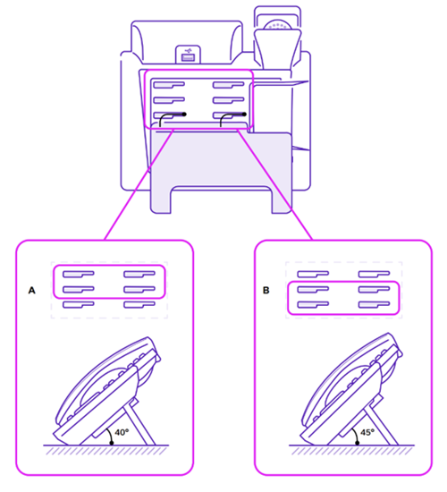

Option A: Stand the phone on a desk
1. Once you’ve unpacked it, turn your phone upside down so you can view the slots.
2. Then slot the phone stand into the slots, depending on the angle you want.
Diagram showing how the stand fits into the back of the phone

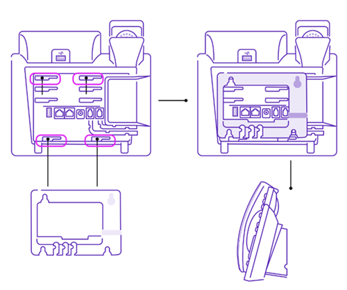

Option B: Mount the phone to a wall
Step 1. Attach the wall‑mount bracket (sold separately)
1. Align the wall‑mount bracket hooks with the slots on the rear of the phone.
2. Slide the bracket upwards until it clicks firmly into place.
3. Make sure it's secure – there should be no movement.
Diagram showing how the wall bracket is attached to the phone

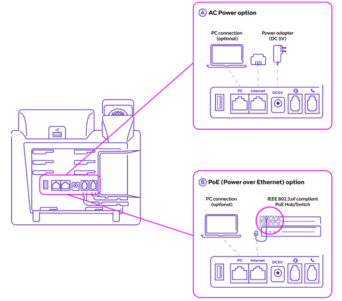

Connect your phone to power and the network
To get your phone working, you’ll either need to connect it to:
  • Mains power.
  • Or Power over Ethernet (PoE).
You can always ask your IT support which option is best for your business.
Diagram showing how the phone is connected to mains power or Power over Ethernet
Option A: Connect your phone to mains power
This involves two steps:
1. Connect to mains power first by connecting the DC plug on the power adapter to the DC5V port on the phone. Then plug in the other end of the power adapter to the mains.
2. Then connect to the network using the Ethernet cable OR Wi-Fi.

Option B: Connect your phone using Power over Ethernet (PoE)
Another option is to use the Ethernet cable provided, by connecting it with a PoE-compliant broadband hub, or LAN switch (if you have one).
For it to be compliant, the hub or LAN switch must be up to IEEE 802.3af standards – read your hub or LAN switch’s user guide or refer to the manufacturer if you’re unsure.
How to connect using Power over Ethernet (PoE)
1. Connect the Ethernet cable between the internet port on the phone and an available port on your broadband hub or LAN switch.
2. On the phone itself, select On from the Wi-Fi field.
3. Finally, select Save.

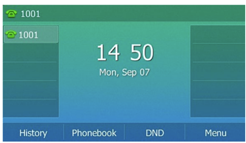

Check you're set up
Once you’ve followed the previous steps, your phone should automatically connect to the network and update its firmware. This might take some time, so please be patient.
Image of the phone screen display when it's correctly set up
  • When it’s finished, the screen will show a symbol of a green phone if it’s been successful. Green phone icon
  • If something’s gone wrong, it’ll show a symbol of a grey phone. Grey phone icon
If this happens, get in touch with our Faults team and we’ll be able to help.
The screen will also show your phone’s line number in the top left corner.
