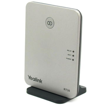

The Yealink RT30 DECT repeater unit on its stand.
You should have:
  • Yealink RT30 DECT Repeater (pictured).
  • Base stand (pictured).
  • USB power cable.
  • Power adapter.
  • Quick start guide.

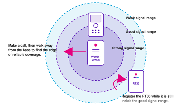

Find the right position for your RT30 Repeater
Your RT30 Repeater needs to stay within your W70B base station's existing coverage so it can receive and extend the DECT signal.
Before setting it up:
  1. Make a call on your handset and slowly walk away from the W70B base station.
  2. Notice where the call quality starts to reduce.
  3. Position your RT30 Repeater slightly closer to the W70B base station than this point.
Don't put your RT30 Repeater somewhere the signal from the base station has already been lost.
Diagram showing three bands of coverage, from a circle close to the device with a strong signal to a circle further away with a good signal, then the furthest circle with a weak signal.
Move the repeater to its final position only after registration is complete.

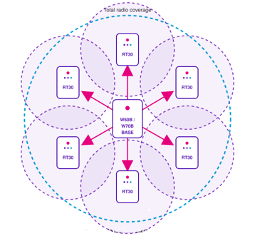

Star layout: up to six RT30 Repeaters
Diagram showing the W70B base surrounded by six RT30 repeaters in a star shape to extend the coverage area.
Each repeater registers directly to the base and must remain within its coverage.

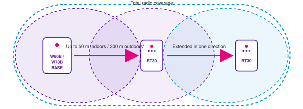

Cascade layout: two repeaters in a chain
Diagram showing the W70B base on the left with an RT30 to the right, and another RT30 repeater further to the right, showing how coverage can be extended in one direction.
Up to 50m indoors / 300m outdoors is the maximum range in ideal conditions. Walls, metal and electrical equipment reduce coverage.
